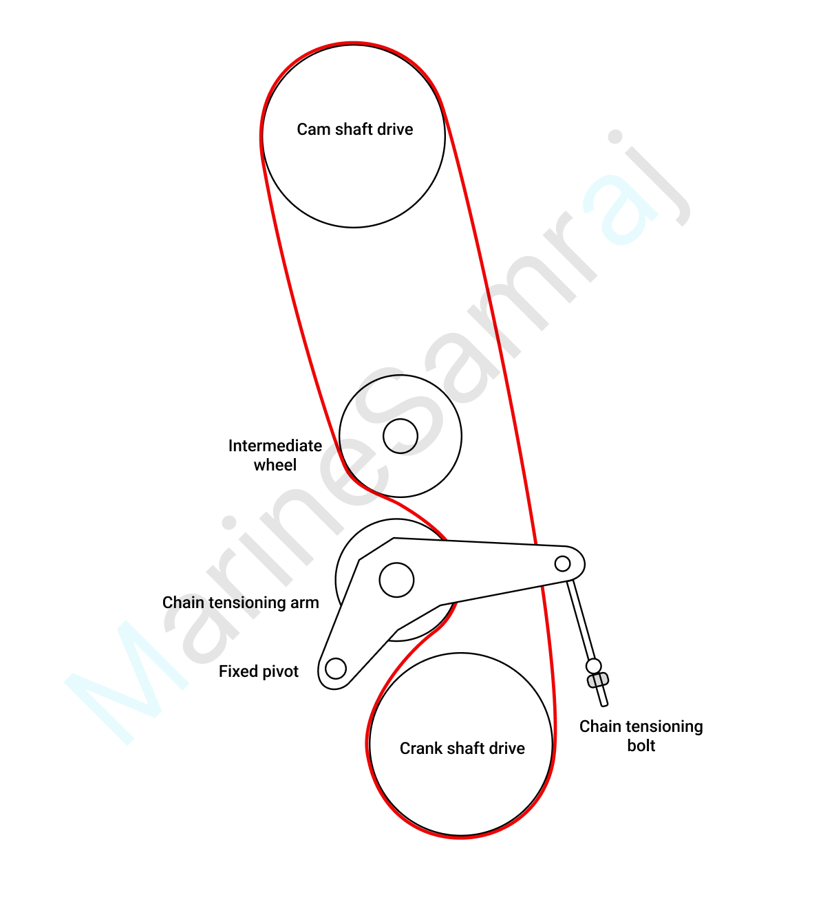

Shown below is the arrangement of a chain drive, which is used to transmit power from the crankshaft to the camshaft.
It consists of chain sprockets mounted on the crankshaft & camshaft. There can be two or more chains.

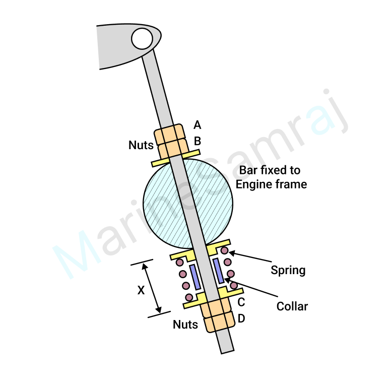

A chain-tightening arrangement is provided, as shown in the fig.
The chain is guided by the guide bars, which has rubber shock-absorbing pads
