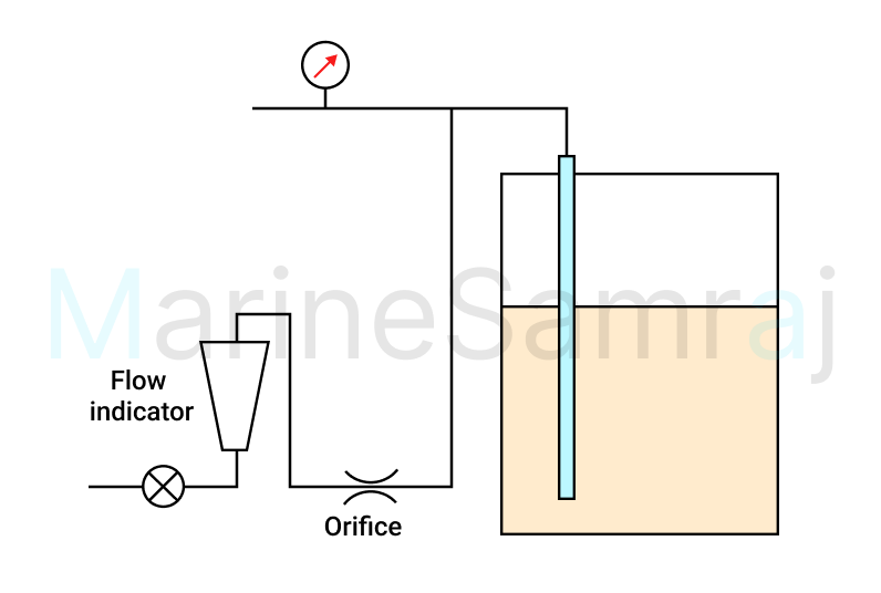

(a) Sketch and describe TWO methods that employ manometric means for measuring tank contents. (6)

### (a) Manometric Methods for Measuring Tank Contents
Manometric tank gauging systems operate on the fundamental principle that the pressure exerted by a column of liquid is directly proportional to its height (level). This hydrostatic pressure is measured and converted into a level reading. The governing principle is given by the formula:
$$ P = \rho \times g \times h $$
Where:
