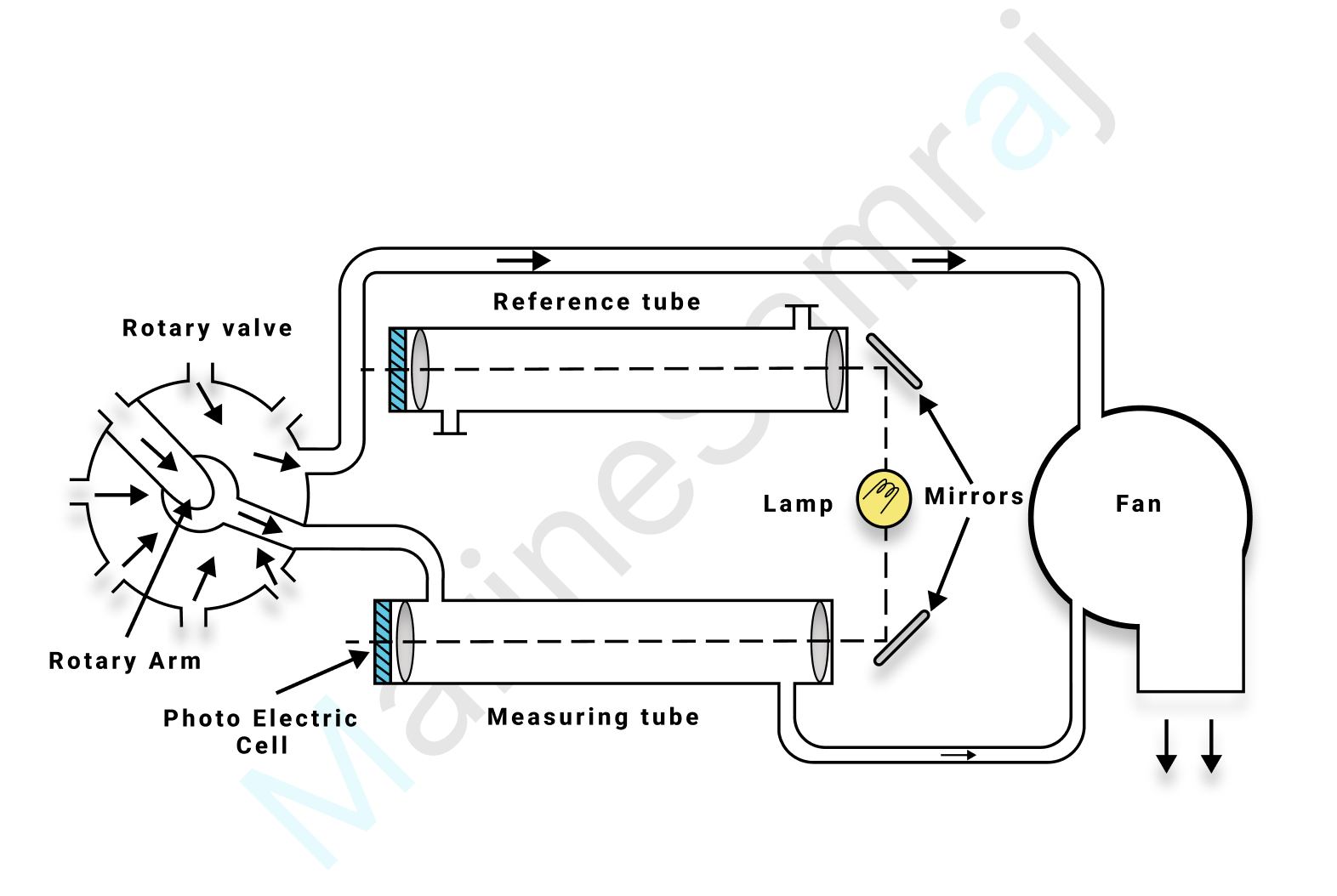

Sketch and discuss the precautions and protections that are provided to minimize the possibility of a diesel engine crank case explosion and the transmission of dangerous flame into the machinery space:
