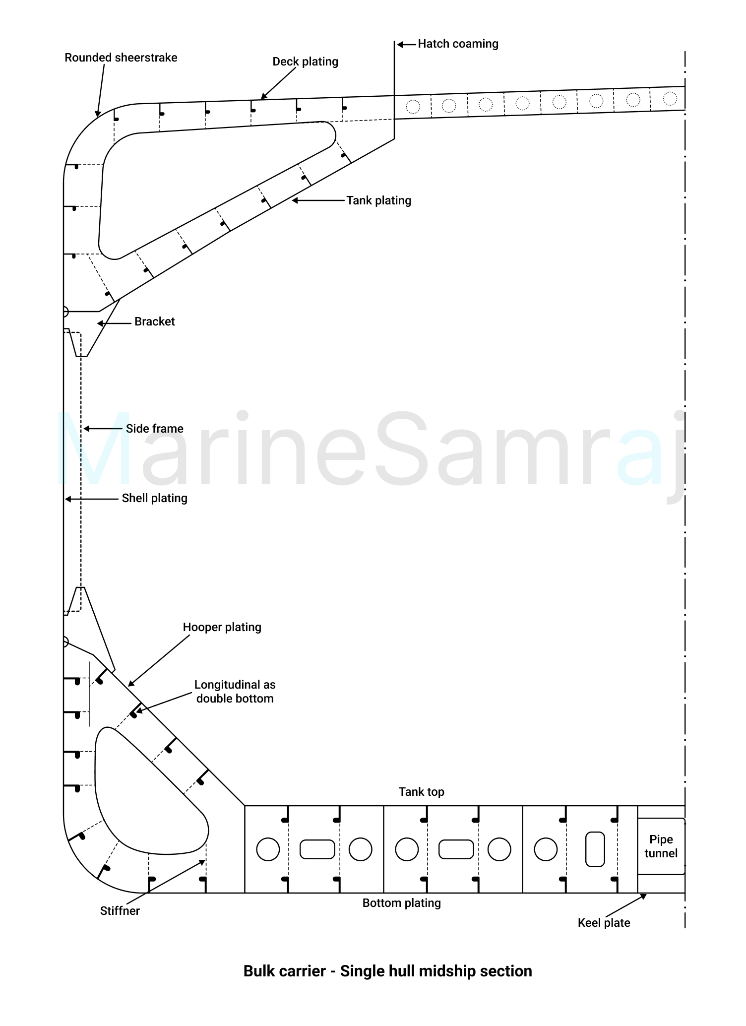

(a) Sketch the cross-section of a bulk carrier with either deep or shallow double bottom showing the type of framing used.

(a) Mid-ship section of bulk carrier:
