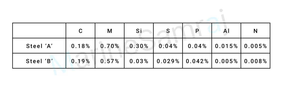

(b) The basic compositions of two ships' plates are given in Table below.
One of the steel mentioned in table is an example of modern practice whilst the other steel is the specification of an old tanker that split into two due to brittle fracture. Compare these two specifications critically and explain which of these two steels would be most resistant to brittle fracture.
