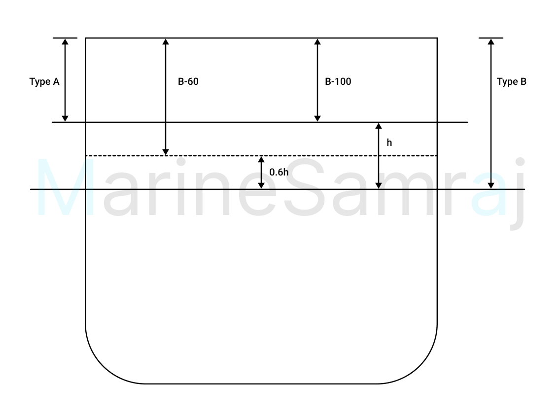

(c) Using a diagram indicate the freeboard of type A, type B, type B60 and type B100 vessels giving an example of each type.
