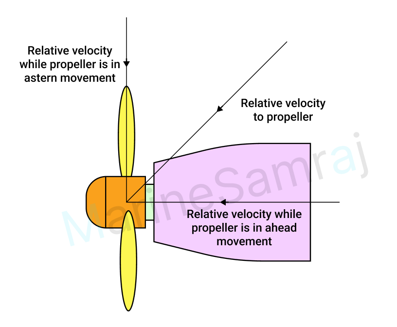

### (a) Reasons for Poor Efficiency of Fixed Pitch Propellers (FPP) in Astern Operation
A Fixed Pitch Propeller's blade is designed as a hydrofoil, optimized for generating thrust efficiently in the forward direction. When rotation is reversed for astern movement, its hydrodynamic efficiency plummets due to several critical factors:
1. **Unfavourable Angle of Attack:**
* The blade profile has a rounded leading edge and a sharp trailing edge for smooth flow attachment in the ahead direction. When going astern, the sharp trailing edge becomes the leading edge.
