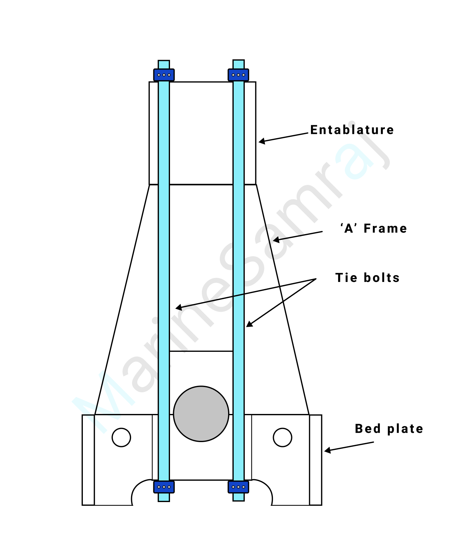

State with reasons, how cracking in EACH of the following locations is caused, rectified and avoided:
(a) 'A' Frames

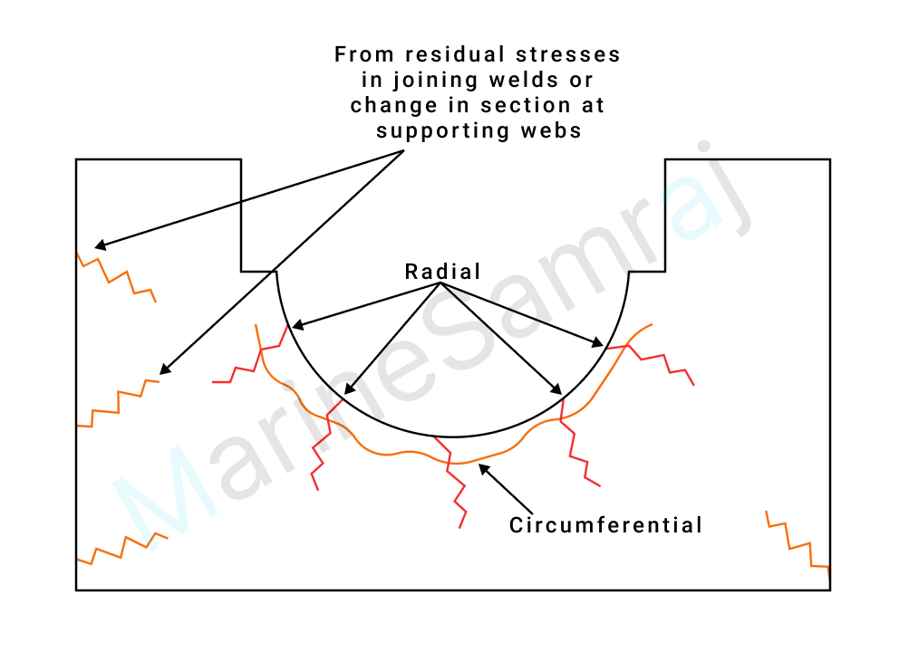

(b) Bed plate longitudinal girders
(c) Bed plate transverse girders
(i) A-Frame
Cause of Cracking:
Stress concentration due to sharp changes in section.
Incorrect preparation of plate edges.
