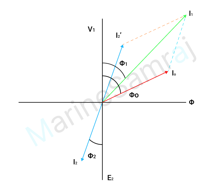

(b) A 100 KVA, 2400/240 V, 50 Hz, 1-phase transformer has no-load current of 0.64 A and a core loss of 700 W, when its high voltage side is energized at rated voltage and frequency. Calculate the two components of no-load current. If this transformer supplies a load current of 40 amp at 0.8 lagging power factor at its low voltage side, determine the primary current and its power factor. Ignore leakage impedance drop (10)
Given,
$$100KVA, \space 2400/ 240V,\space 50Hz,\space 1 - \phi$$
To calculate no load components:
Primary input current $$I_o = 0.64 A$$
