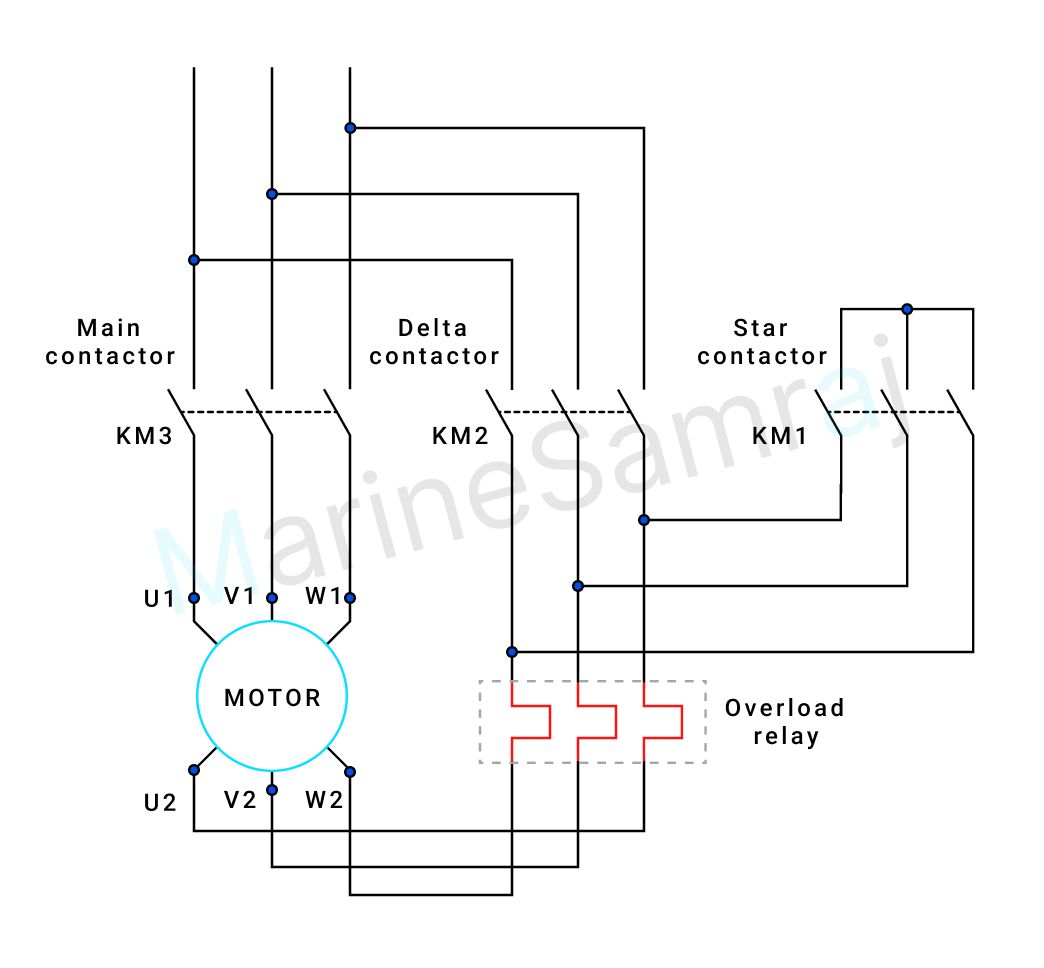

(a) Overcoming High Starting Current:
(i) Star-Delta Starting:
The stator windings have end connections brought out to a starter box with six terminals.
These are first connected in a star configuration for starting, which reduces the voltage and hence the current.
