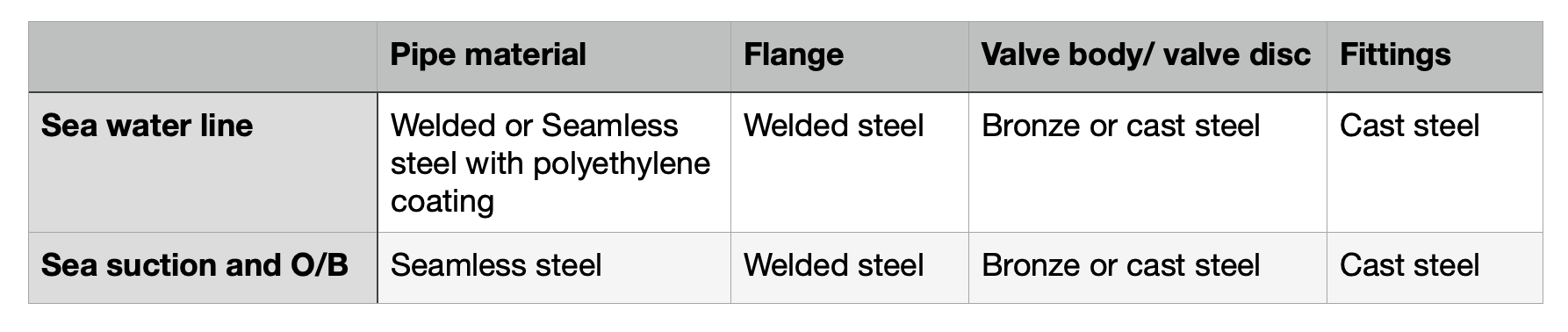

(a) Outline your proposal for the need for various types of piping for different systens.
(b) State the necessary requirements for approval.

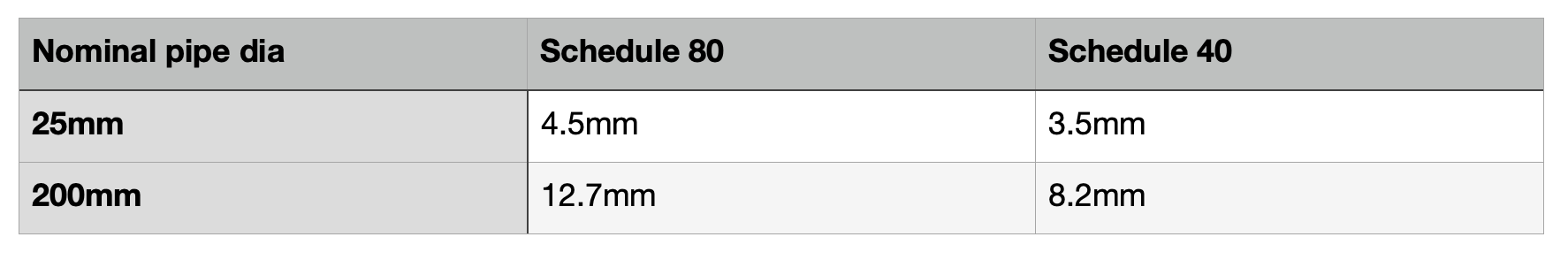

For manufacturing and installation of seawater service pipes on the ship, the following considerations are to be made :
(i) Selection of Material
Selection of the material must be based on the ability to resist general and localised corrosion such as pitting, impingement attack and cavitation throughout the pipe.
It must have the ability to resist stress corrosion & corrosion fatigue.
