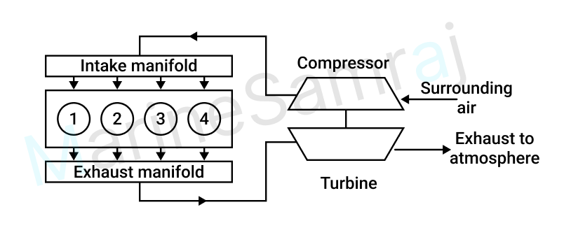

(a) Difference between pulse and Constant Pressure turbocharger systems.
In the constant-pressure turbocharging system, each cylinder's exhaust gases are directed to a common exhaust gas manifold. From the manifold, the exhaust gases are channeled to a single entry point leading to the turbine. This system usually employs one turbocharger, but for engines with a higher number of cylinders, multiple turbochargers may be used. The heat energy of the exhaust gases is utilized to drive the turbine.
Advantages:
The system efficiently harnesses exhaust gas energy to drive the turbine, resulting in better efficiency.
