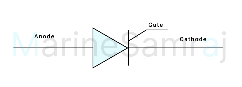

(a) What is a silicon controlled rectifier (SCR)? How is the breakover voltage of the SCR defined? (6)

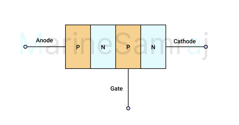

A SCR is a 4-layered PNPN switching solid-state current controlling device. These are unidirectional devices. SCR is triggered by a current going into the gate.
It has three modes of operation:
Forward blocking mode (OFF state)
Forward conducting mode (ON state)
