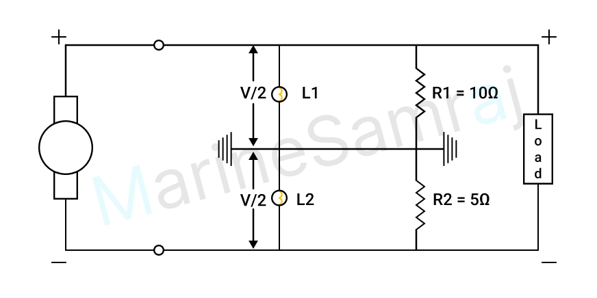

(b) Two earth lamps at 120 V, 15 W are used on a 110 V distribution circuit. Due to damage to a motor, the resistance of the positive line is reduced to 10 ohm and that of the negative line to 5 ohm. Find the voltage across each lamp and the extra load on the generator due to the fault (10)
(b)
$Earth \space lamp \space = \space 120V, \space 15W$
$$W \space = \space {{V^2} \over R}$$
