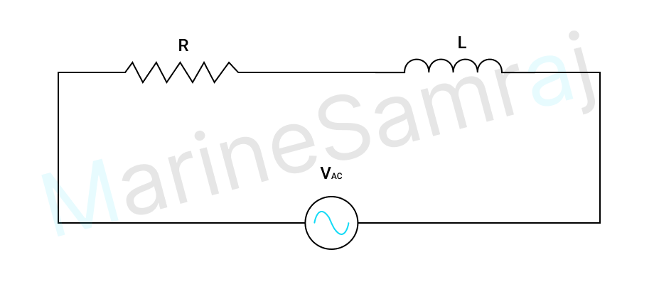

(b) A circuit has a resistance of 3Ω and an inductance of 0.01H. The voltage across its ends is 60V and the frequency is 50Hz. Calculate (10)
(a) The impedance
(b) The power factor
(c) The power absorbed.
