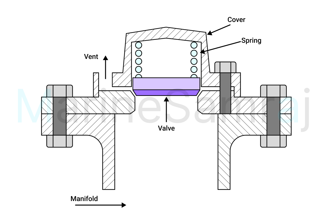

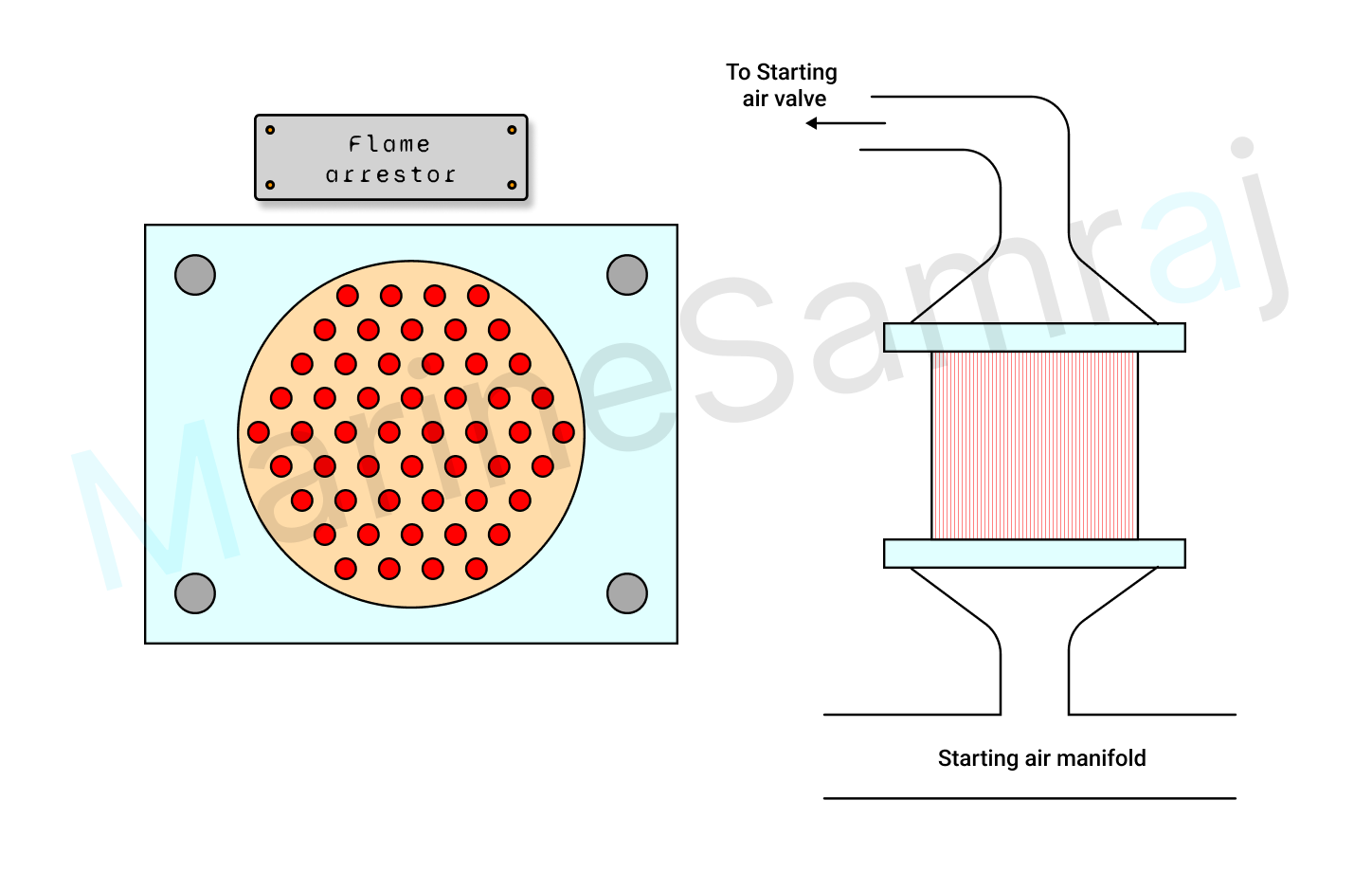

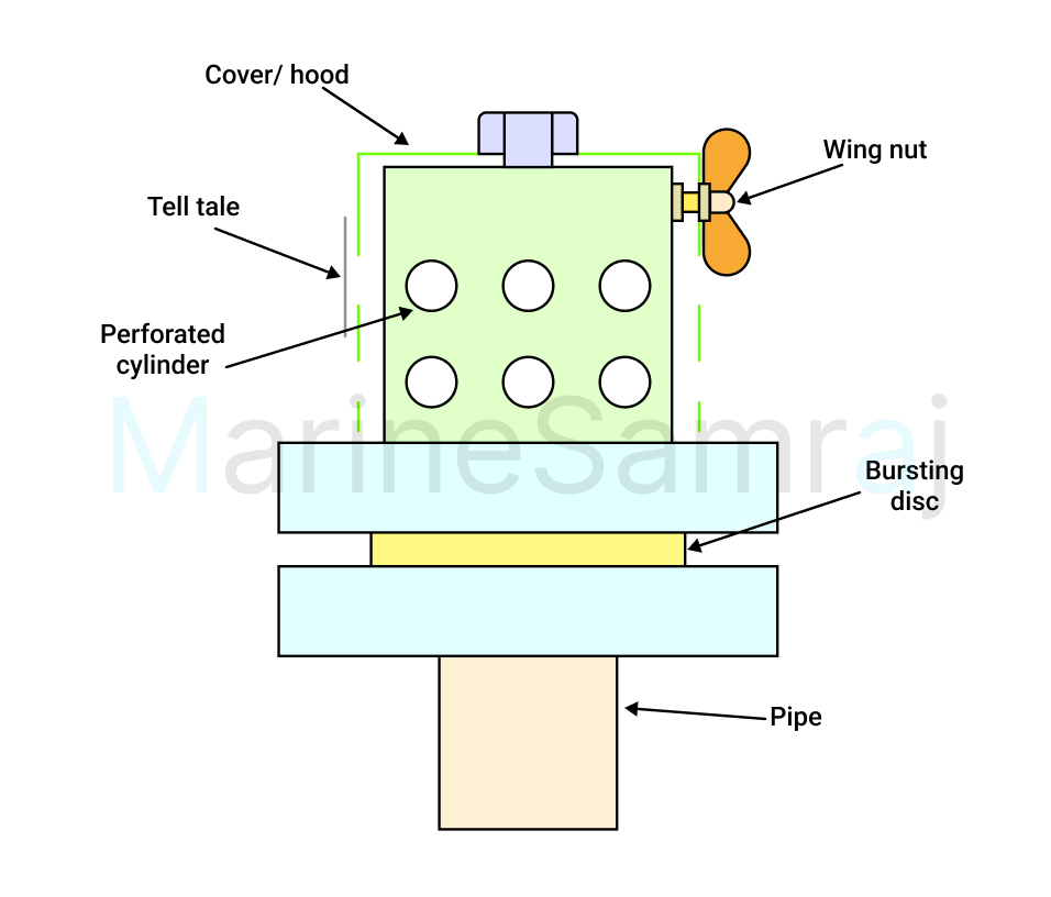

Why does an explosion occur in the starting air line of an interal combustion engine and how can the possibility of such an occurrence be reduced? Sketch and describe devices, which may be fitted to reduce the severity of such an explosion. State the attention which air starting valves should be given before maneuvering passage.
