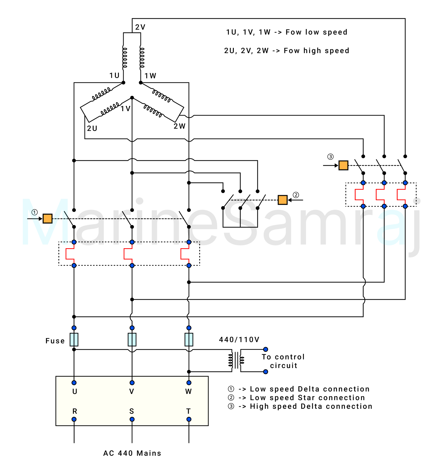

With reference to a 3-phase AC cage motor driven cargo winch:
(a) Sketch a circuit diagram for a pole change motor
(b) Describe how speed change and braking are achieved
(a) Circuit diagram for a pole change motor:
(b) Speed Change and Braking Mechanism:
