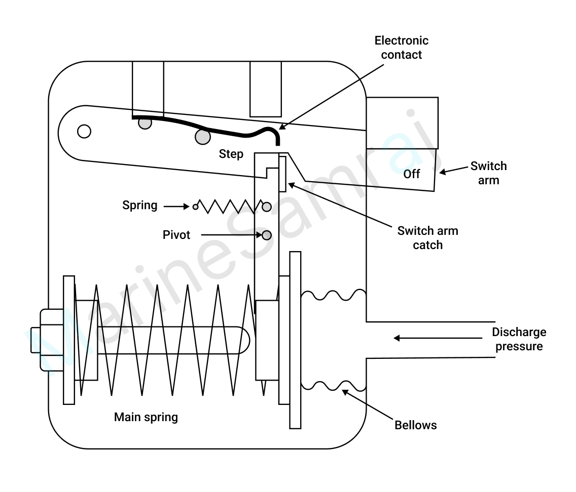

(a) Sketch and describe a high pressure cut-out in a refrigeration system.

(a) A high-pressure cut-out in a refrigeration system is a safety device that protects the system from operating at dangerously high pressures. It consists of a bellows connected to the compressor discharge, a spring, an adjustment screw, and a switch arm. Under normal conditions, the switch arm is held up, maintaining electrical contact. When pressure exceeds the set limit, the bellows expands, releasing the switch arm, and the compressor cuts out, preventing further damage. The cut-out needs manual reset after troubleshooting and pressure returns to safe levels. It ensures system safety and prevents over-pressurization risks.
