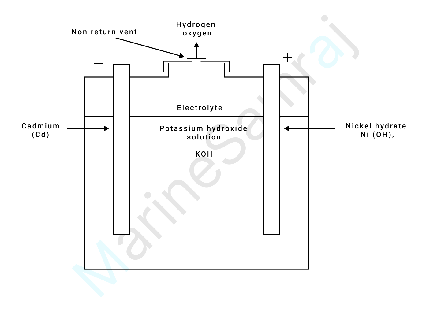

With reference to alkaline batteries used on board ship.
(a) Describe the operation of a battery cell and state the material used. (6)
(b) Describe how the cells are mounted to form a battery. (5)
(c) State the advantages and disadvantages compared with lead-acid batteries. (5)
(a) The common form of alkaline cell is Nickel cadmium type.
In this type of battery,
Cathode: The positive electrode is made up of nickel oxyhydroxide (NiOOH)
Anode: Negative electrode is made of cadmium (CD)
