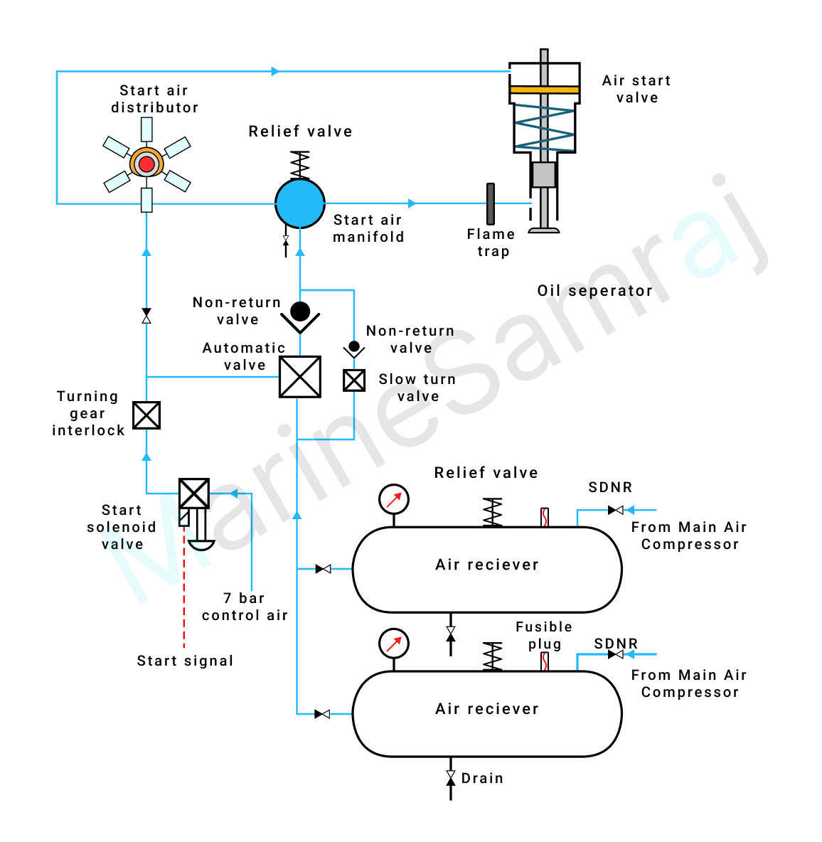

(c) Describe, with the aid of a sketch, an air starting system, explaining how the slow turning system operates. (10)

(b) The slow-turning system activates When the time interval between two engine operations exceeds the pre-set timer (usually 30 minutes).
