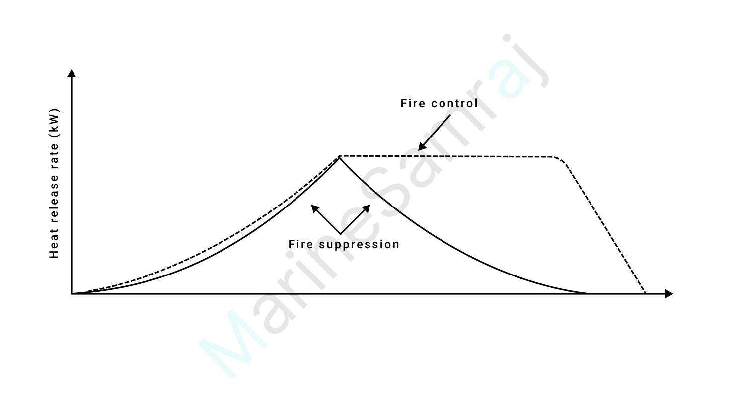

(a) Explain, with the aid of a Heat Release versus Time diagram, the difference between fire control and fire suppression
(b) State the limitations of using glass bulbs to activate sprinkler heads and suggest, with reasons, an alternative mechanism.
(c) The safety devices incorporated in the system.
(d) The parameters governing the volume of the pressure tank
(a) Fire control can be defined as limiting the size of the fire by distributing the water so as to decrease the heat release rate and pre-wet adjacent combustibles whilst controlling deck-head gas temperatures to avoid structural damage. Fire suppression can be defined as quickly lowering the heat release rate of a fire and preventing its regrowth using sufficient application of water through flames to the seat of the fire.
