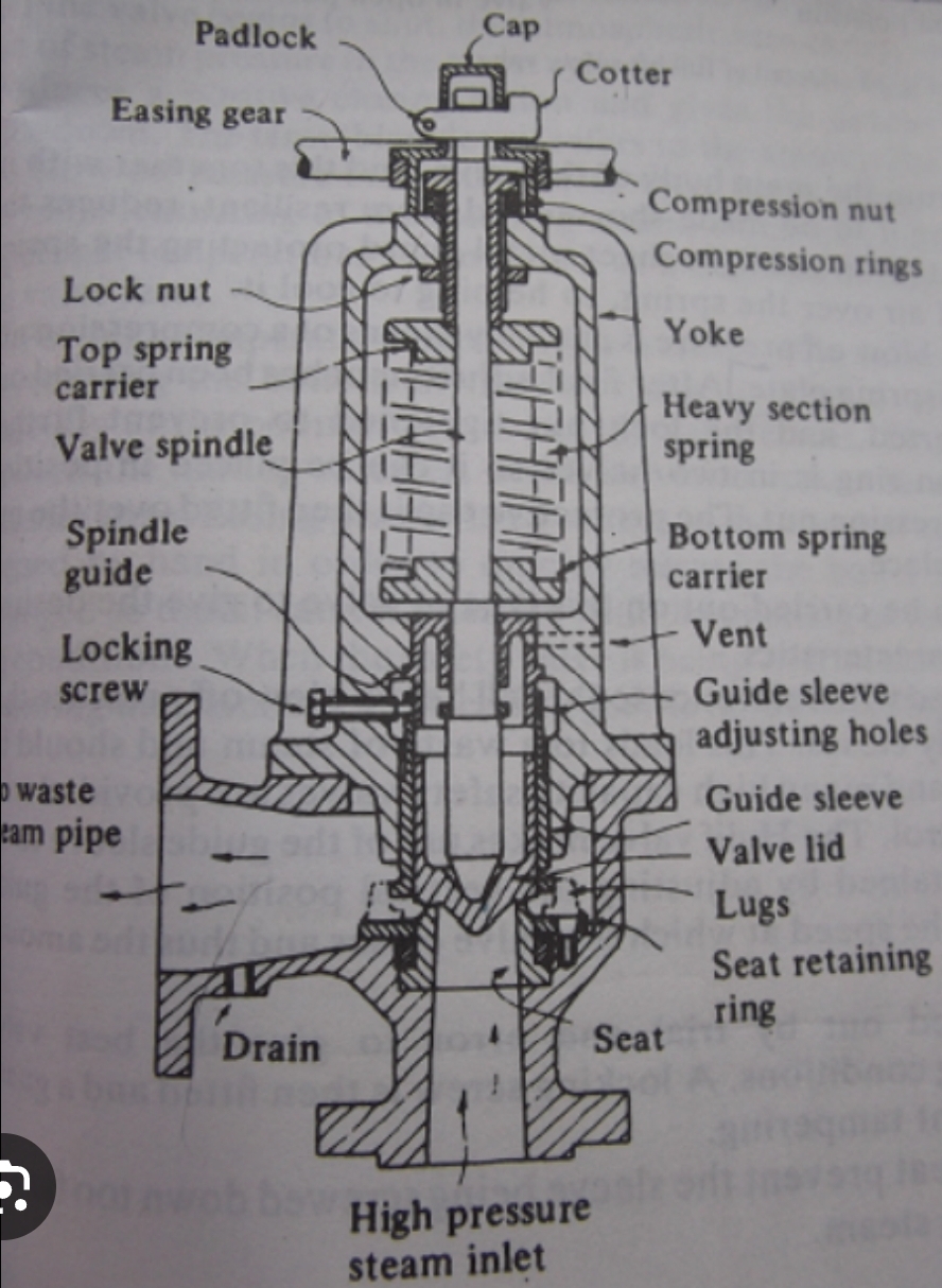

With reference to auxiliary boiler safety valves: a) Describe, with the aid of a sketch, the safety valves for an auxiliary boiler. (6) b) Identify, with reasons, the parts that require particularly close attention during overhaul; (5) c) Describe how the safety valves are reset after an overhaul.(5)
### a) Description of an Auxiliary Boiler Safety Valve
A typical safety valve for an auxiliary boiler is of the **Improved High-Lift** spring-loaded type. Its primary function is to automatically discharge steam if the boiler pressure exceeds the safe, predetermined limit, and to close again once the pressure has been reduced to a safe level.
**Construction:**
* **Valve Body:** A robust casing, usually made of cast steel, designed to withstand high pressure and temperature. It contains the inlet from the boiler and the outlet to the atmosphere or a safe discharge line.
