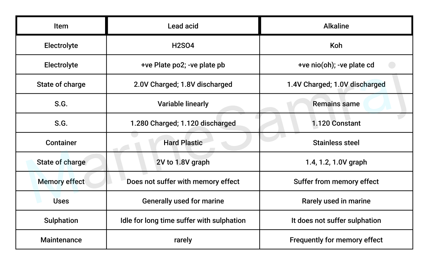

With reference to batteries onboard:
(a) Distinguish between 'Lead acid cell' and 'Alkaline Cell' (6)
