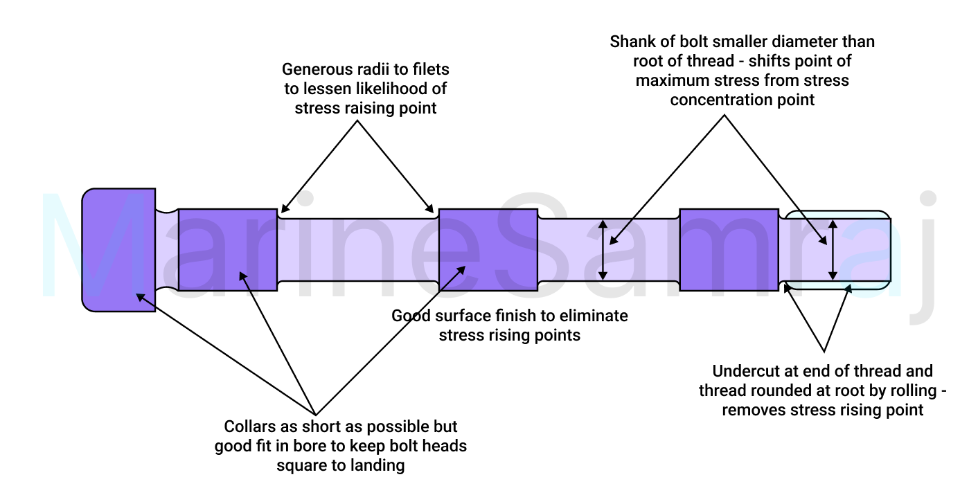

(b) Identify the features incorporated into bolt design to inhibit failure
