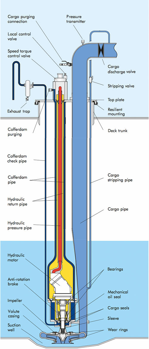

(a) Sketch a suitable cargo pumping and stripping system, labelling the component parts and indicating the direction of fluid flow. (10)

### (a) Chemical Tanker Cargo Pumping and Stripping System (10 Marks)
#### Concept and System Selection
For chemical tankers, the primary considerations for cargo handling are safety, prevention of cross-contamination between different cargo parcels, and minimizing cargo residues to comply with stringent environmental regulations (MARPOL Annex II). The most common and effective system that meets these requirements is the **submerged deepwell pump system**, with one dedicated pump per cargo tank.
This design offers complete segregation of cargo, eliminating the need for a traditional pump room and complex piping within the tanks, which significantly reduces operational risks and cleaning times.
