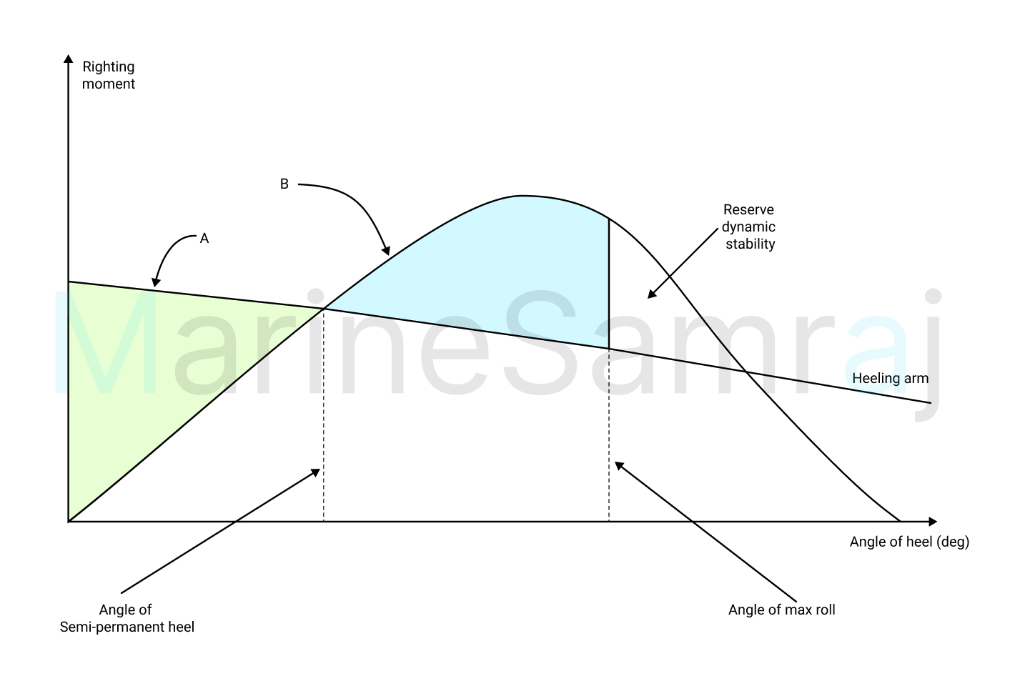

(a) Dynamical Stability is defined as the amount of energy required to heel a ship from its upright equilibrium position to a specific angle of heel. It provides a measure of the vessel's stability by considering its behaviour in response to dynamic external forces , such as wind or waves.
The concept compares the heeling moment energy (from external forces) and the righting moment energy (from the ship's stability).
The ship will absorb the energy imparted by the heeling moment. If the righting energy is greater than the heeling energy, the ship will stabilize; otherwise, it may capsize.
Areas Under the Curve:
