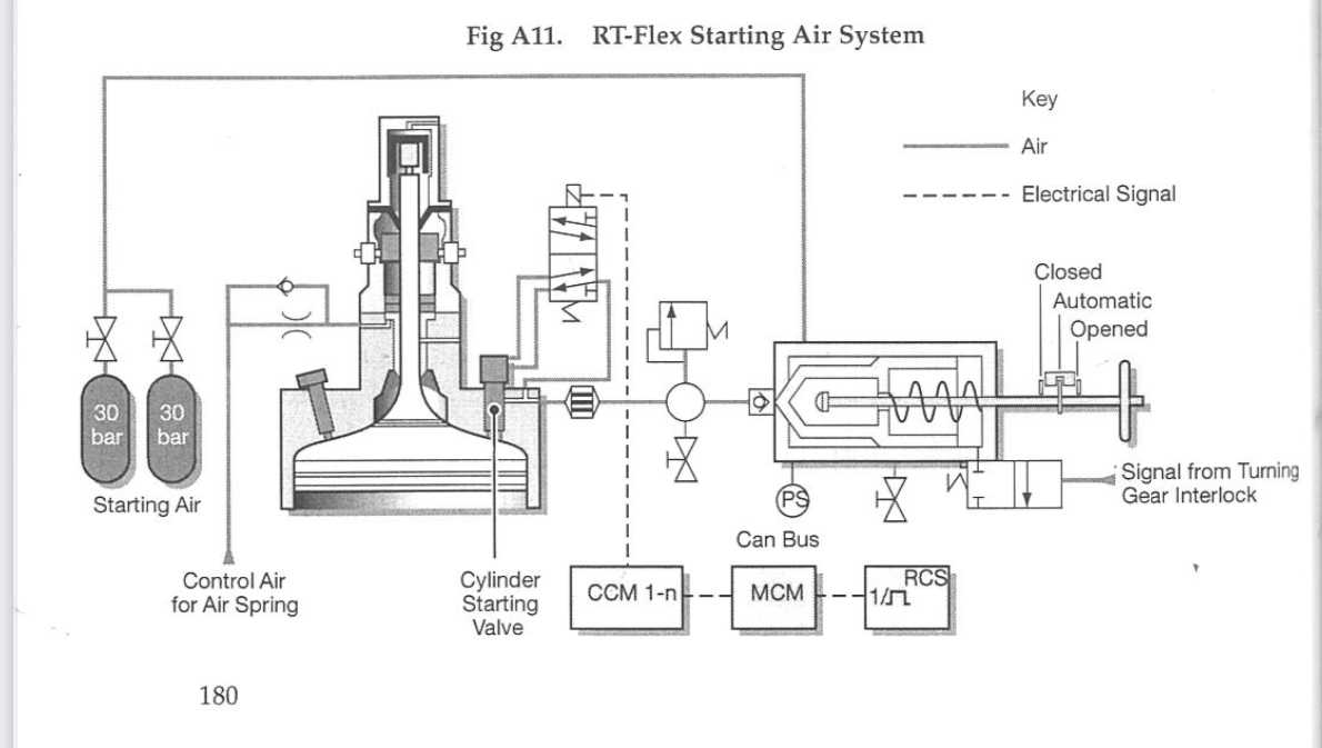

(c) Describe how starting air valves are regulated.
