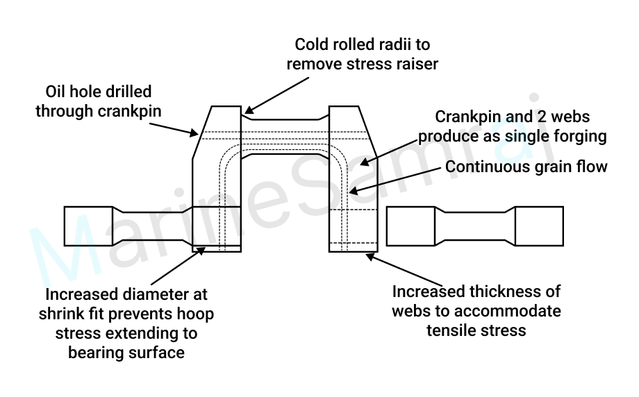

(b) With sketches how it is inhibited in practice.

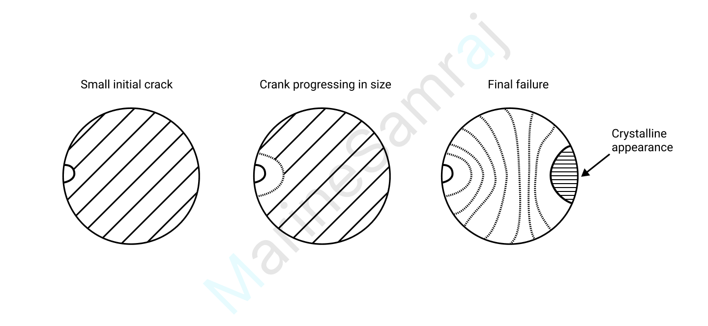

(c) How it is identified in its initial, intermediate and final stages prior to failure.

Smaller crankshafts , such as those in 4-stroke medium-speed engines, are typically solid forged , with a continuous grain line structure . This enhances fatigue resistance and overall strength.
Larger crankshafts , as used in 2-stroke slow-speed crosshead engines, are often semi-built or fully built . These are fabricated from separate forged crank throws, with main journals shrink-fitted into machined holes in the webs. While the crank throw may have continuous grain flow, the shrink-fit areas are potential weak spots .
