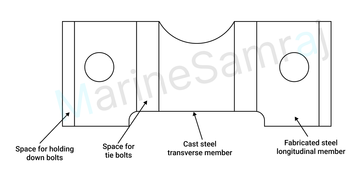

(c) State the factors which influence the possibility of fatigue cracking of a bed-plate transverse girder and explain how the risk of such cracking can be minimized.
