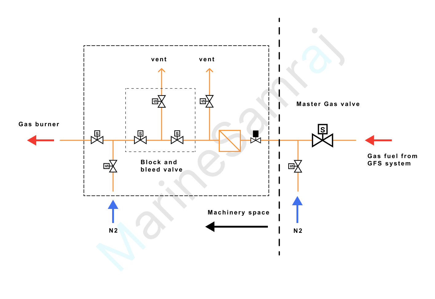

(a) The gas valve unit (GVU) controls the gas feed pressure according to the engine load. Throughout the engine operation, the load conditions are dynamic and change which in turn requires changing gas pressure along with ensuring safe operation of engine with a timely response to changing load conditions. This task is achieved by a series and parallel combination of shuttle and vent valves which form a GVU (gas valve unit). A schematic diagram of the GVU process system is shown in the figure. To achieve the best performance of the engine in response to transient conditions, the GVU must be placed as close as possible to the engine. Recommended fuel gas pipe length between GVU and engine should be less than 10 m
