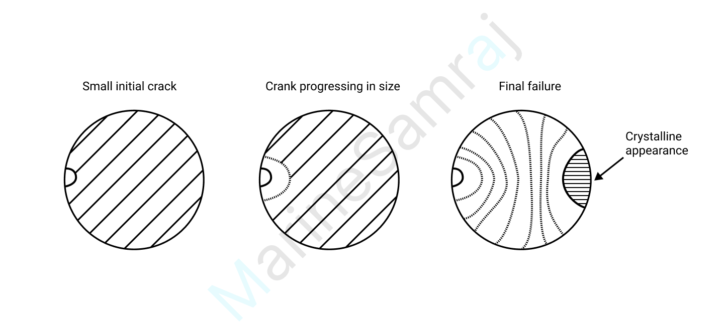

With reference to machinery parts under cyclic loading, describe, with the aid of sketches, the propagation of even the smallest of cracks can lead to total component failure. (16)
### **Introduction to Fatigue Failure under Cyclic Loading**
Fatigue is a phenomenon leading to the fracture of a material under repeated or fluctuating stresses (cyclic loading), which have a maximum value less than the ultimate tensile strength of the material. It is a progressive and localized structural damage that occurs when a material is subjected to cyclic loading. The insidious nature of fatigue failure is that it occurs without any obvious prior warning, often resulting in catastrophic failure of critical machinery components like crankshafts, connecting rods, and propeller shafts.
### **The Three Stages of Fatigue Failure Propagation**
The process of fatigue failure can be broken down into three distinct stages, from the initiation of a microscopic flaw to the final, total fracture of the component.
