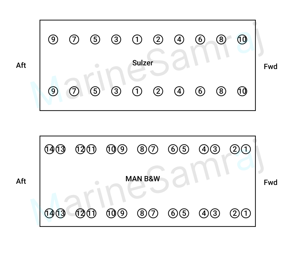

(a) Function:
The main function of tie rods is to keep the entire engine structure in compression .
This increases the fatigue strength of the engine structure.
It ensures proper running gear alignment .
