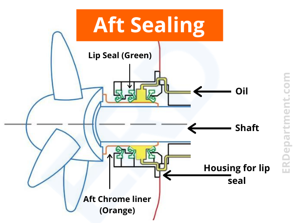

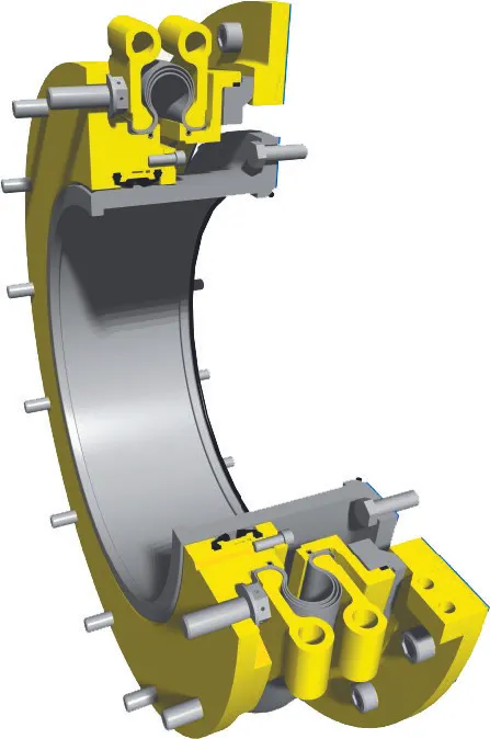

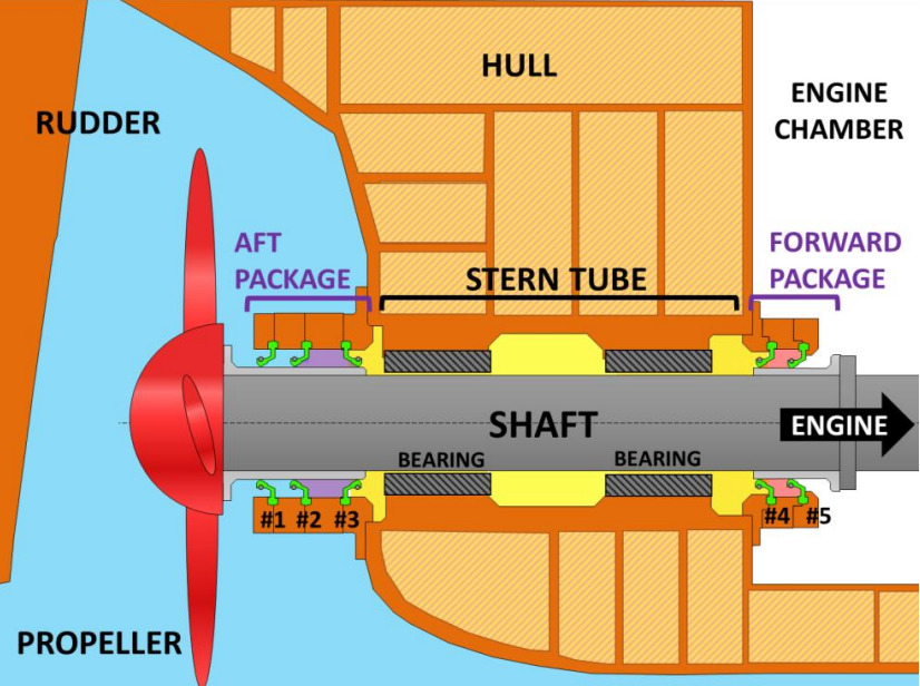

With reference to radial lip seals for propulsion shafting:
(a) Describe, with the aid of a sketch, an outboard seal arrangement as fitted to an oil lubricated stern tube (8)
(b) Explain, with reasons, the possible actions that should be taken in the event of loss of oil from the header tank (8)
### (a) Outboard Seal Arrangement for an Oil-Lubricated Stern Tube
#### Concept and Function
An outboard seal arrangement for an oil-lubricated stern tube is a critical component that serves two primary functions:
1. **Prevent Lubricating Oil Leakage**: It stops the stern tube lubricating oil from escaping into the sea, thus preventing environmental pollution and loss of lubricant.
