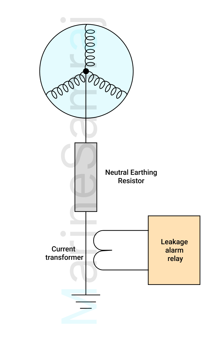

(d) (i) Earthed Neutral System:
In this system, the generator star point is connected directly to the ship’s hull.
Any earth leakage current will therefore complete a circuit back to the generator.
A Neutral Earthing Resistor (NER) is fitted to limit the earth fault current to about 5 Amps .
