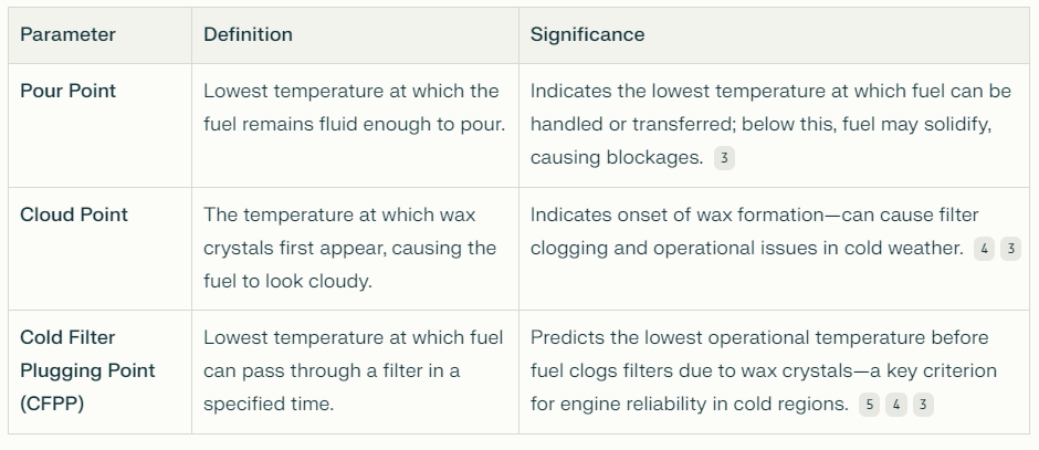

(a) Pour point, cloud point and cold filter plugging point.
