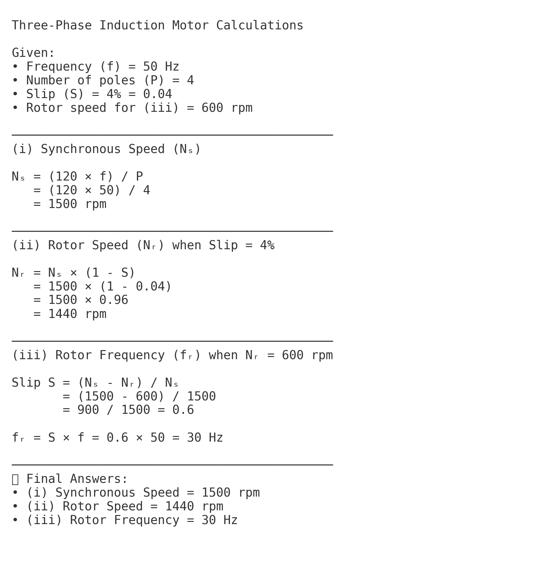

(b) A three-phase induction motor is wound for four poles and is supplied from a 50 Hz system. Calculate: (10)
(i) The synchronous speed
(ii) The speed of the rotor when the slip is 4 per cent
(iii) The rotor frequency when the speed of the rotor is 600 r/min.
