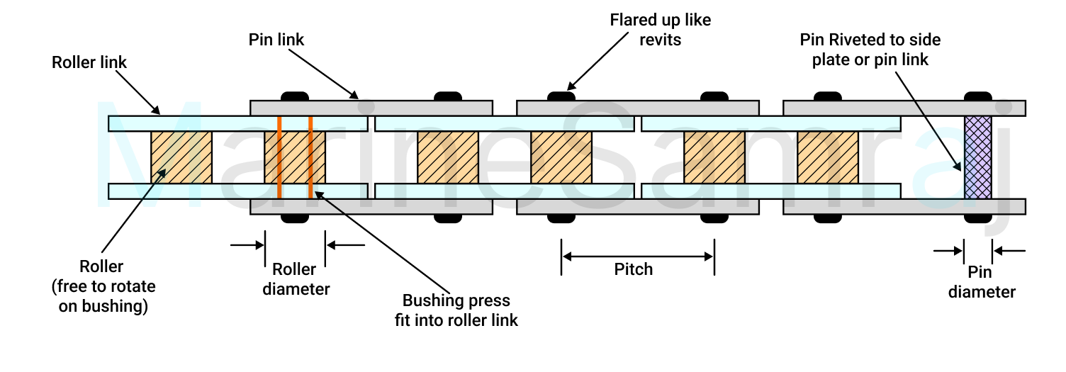

(a) State the cause of chain elongation in service, using a sketch of a section of a camshaft roller chain to illustrate your answer

(a) Cause of chain elongation in service:
The primary cause of chain elongation is wear-down between the pins and bushes in the roller chain. Over time, this wear effectively increases the pitch of the chain (the distance between the centres of adjacent pins), causing the chain to elongate.
As the chain's pitch increases, it no longer matches the pitch of the sprocket teeth, leading to:
Excessive wear on the teeth of the sprockets.
