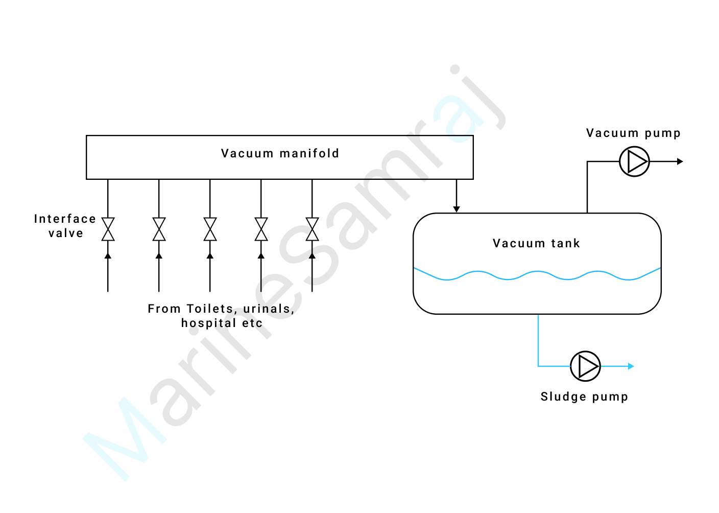

With reference to Vacuum Sewage Systems:
(a) Sketch & Describe a Vacuum sewage system.
(b) State the advantage of Vacuum sewage system.
(c) State the different causes of dropping vacuum.
### (a) Sketch & Description of a Vacuum Sewage System
**Concept**
A vacuum sewage system utilizes a pressure differential to transport black water (sewage) from toilets and urinals to a central collection tank. The piping network is maintained under a constant vacuum (typically -0.4 to -0.6 bar). The sanitary fixtures themselves remain at atmospheric pressure until flushed. When a toilet is flushed, a discharge valve opens for a few seconds, and the higher atmospheric pressure in the bowl forcefully pushes the contents into the vacuum piping. The high-velocity slug of sewage, mixed with entrained air, travels through small-diameter pipes to the collection tank.
**Components & Operation**
