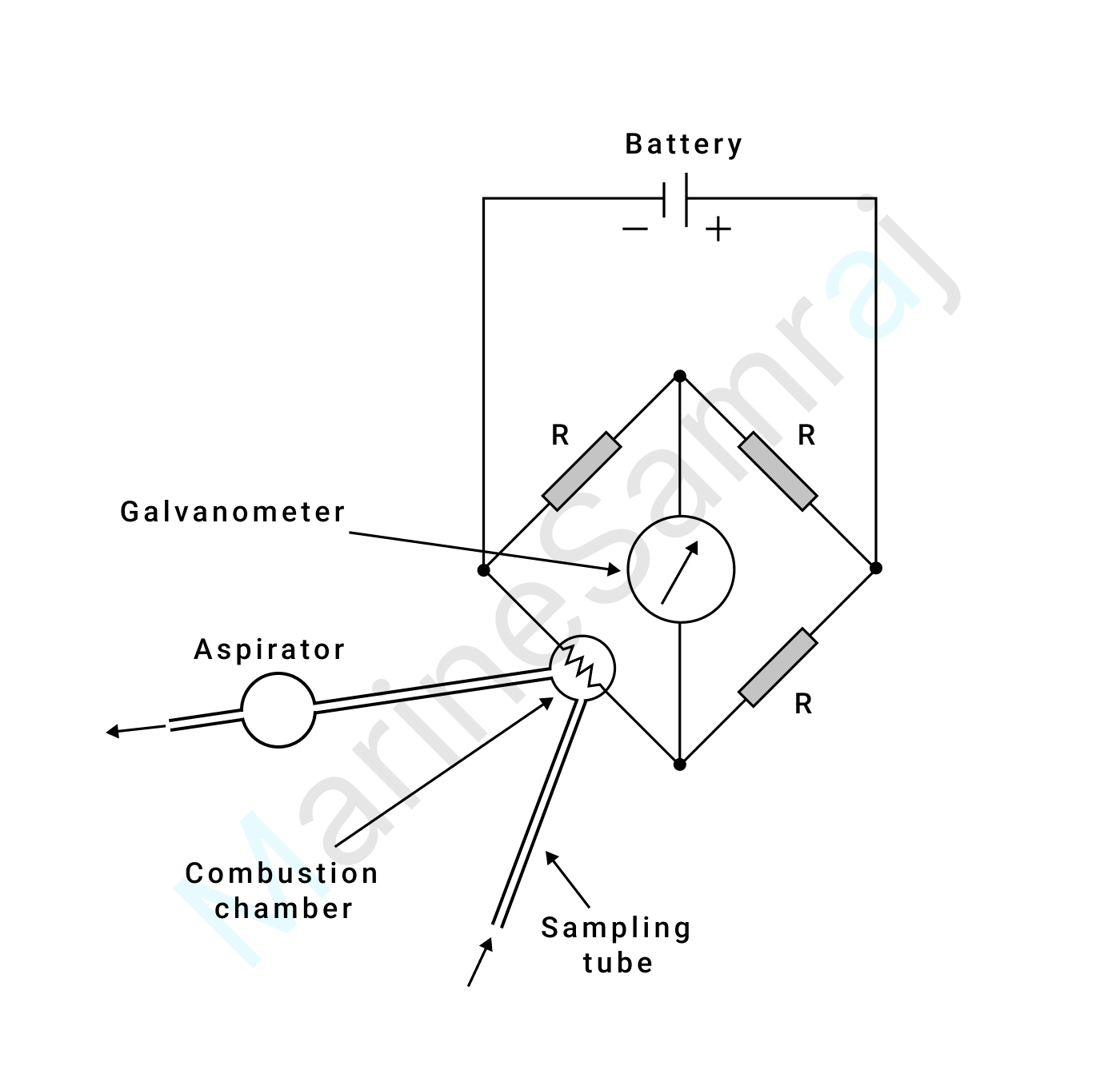

(a) (i) Sketch and describe the operation of an explosimeter suitable for testing pump rooms or tank

(a) (i) An Explosimeter is used to test for the presence of flammable gases or vapors in spaces like pump rooms or cargo tanks.
Consists of a Wheatstone bridge circuit powered by a battery.
Contains three fixed resistances and one resistance that is a hot filament within the combustion chamber.
A galvanometer measures the current flow in the circuit and is scaled to indicate gas concentration as a percentage of the Lower Flammable Limit (LFL) or in parts per million (ppm).
