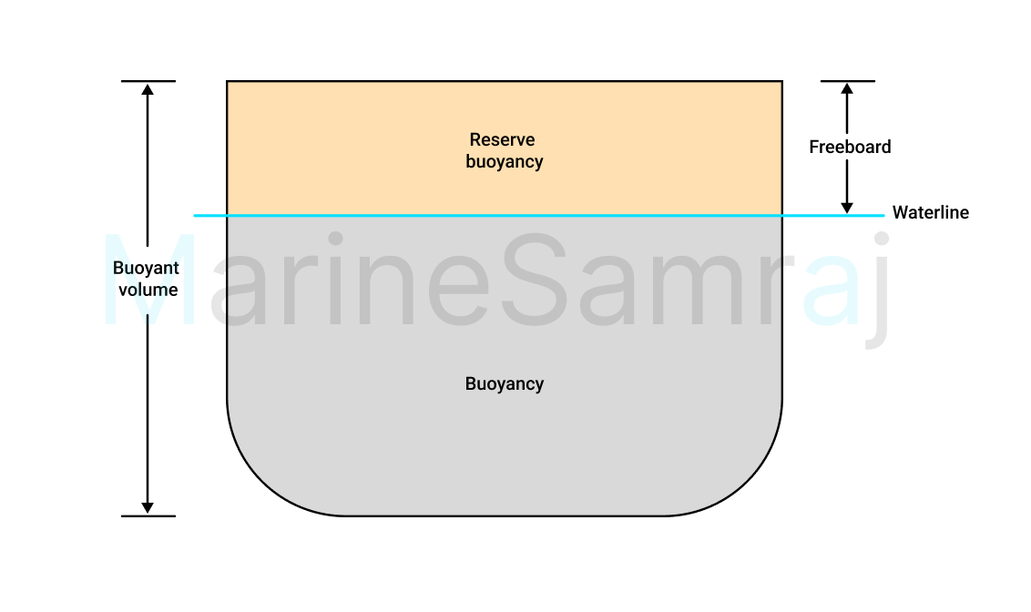

(a) Reserve Buoyancy
Reserve buoyancy is the watertight volume above the waterline of a vessel. It represents the potential buoyancy that can be utilised to keep the ship afloat when additional weight is added or if some buoyancy is lost due to damage (e.g., bilging).
When a mass is added to the ship or buoyancy is lost (e.g., due to flooding of a compartment), the reserve buoyancy is converted into active buoyancy by an increase in draught .
If the lost buoyancy (due to flooding or damage) is greater than the reserve buoyancy , the vessel will no longer have sufficient buoyant force to counteract its weight, causing it to sink .
