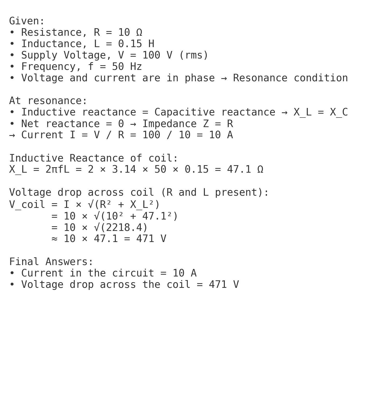

(b) A coil having a resistance of 10 ohm and an inductance of 0.15 H is connected in series with a capacitor across a 100 V, 50 Hz supply. If the current and the voltage are in phase what will be the value of the current in the circuit and the voltage drop across the coil? (10)
