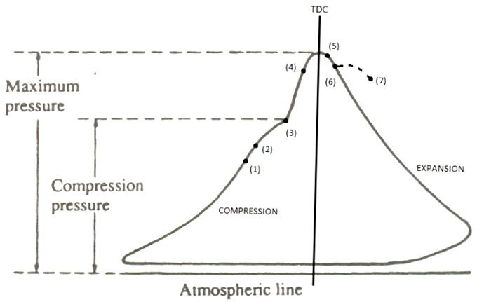

### (a) Purpose of VIT (Variable Injection Timing)
Variable Injection Timing (VIT) is a system designed to automatically advance or retard the start of fuel injection relative to the piston's position, primarily to optimize engine performance across a wide load range. Its main purpose is to maintain the maximum combustion pressure (Pmax) at its optimal design value, thereby ensuring maximum fuel efficiency (lowest Specific Fuel Oil Consumption - SFOC).
**Mechanism and Principles:**
1. **Operation at Part Load (e.g., below 85% MCR):**
