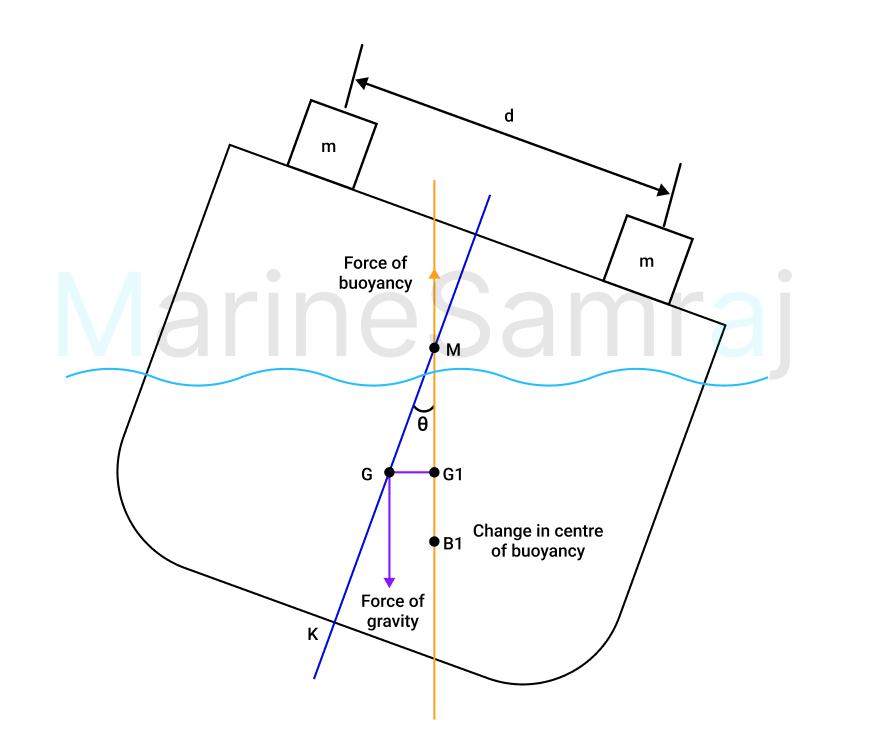

(a) Sketch and Describe briefly the inclining experiment and explain how the results are used. (6)

(a) An inclining experiment is conducted to determine a ship's metacentric height (GM) and, consequently, the location of its centre of gravity (CG). Knowing the CG of an empty vessel allows for calculations of its position under various loading conditions.
The inclining experiment is performed on:
Newly built ships.
After major alterations to the vessel.
