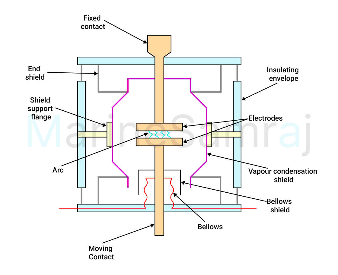

1. Vacuum Circuit Breaker (VCB):
In VCBs, the fixed and moving contacts, along with the arc shield, are housed in an arc-interrupting chamber with a high vacuum. The vacuum's excellent dielectric strength allows for very short contact separation and rapid recovery of insulation strength after each interruption .
Merits:
