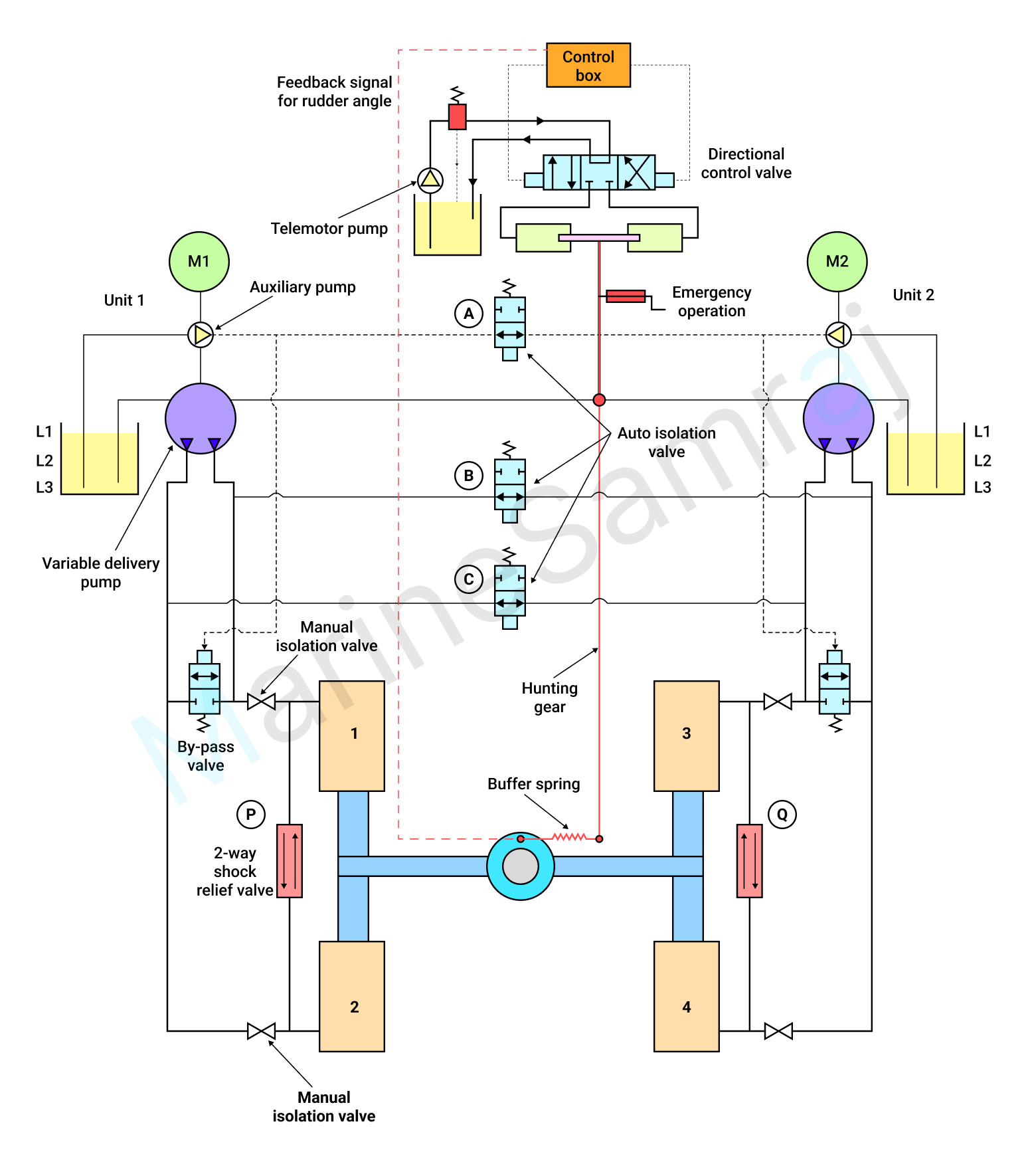

(a) Explain with a diagram, a "failsafe steering gear" suitable for use on a tanker of more than 100000 T dwt. (8)

### (a) Failsafe Steering Gear for Tanker > 100,000 DWT
For a tanker exceeding 100,000 DWT, SOLAS Chapter II-1, Regulation 29 mandates a high degree of redundancy. The main steering gear must consist of two or more identical power units. A failure in one power unit or its associated piping must not render the other power unit inoperative. The most common system that meets and exceeds these requirements is the **Four-Ram Electro-Hydraulic Steering Gear** of the Rapson Slide type.
#### Concept of 'Failsafe'
