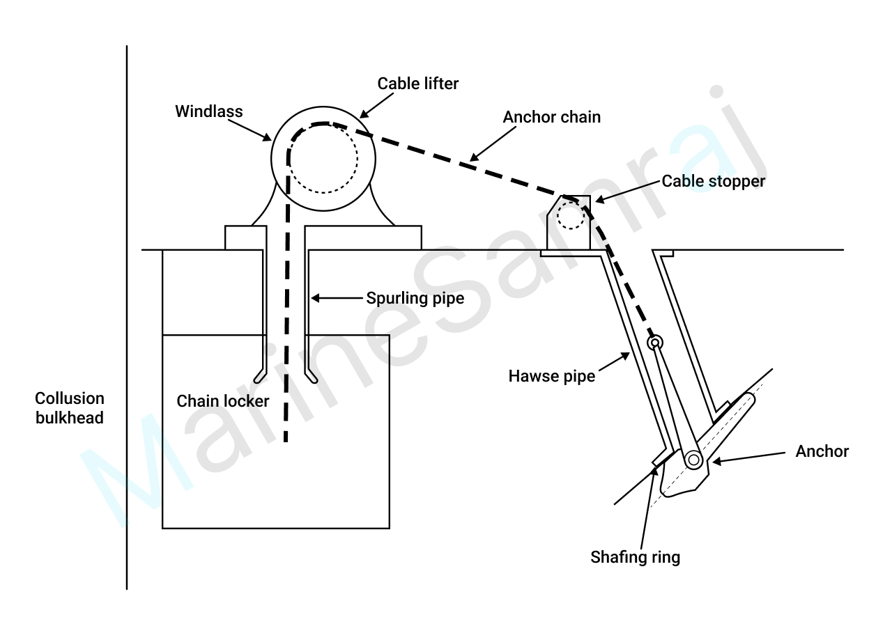

(b) Explain with suitable sketches how the windlass is relieved of strain when riding at anchor. (8)
