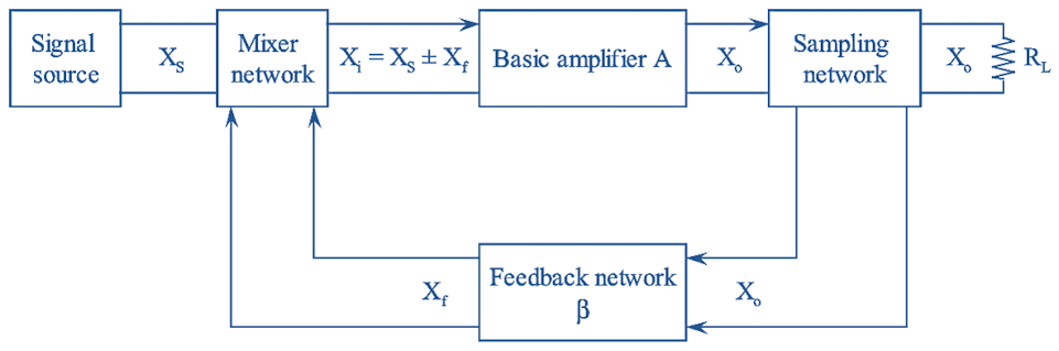

With the aid of a block diagram, briefly describe the effect which negative voltage feedback has on an amplifier and state the advantages resulting from the use of negative feedback. (16)
Effects of Negative Voltage Feedback on an Amplifier
Reduction in Gain: The overall closed-loop gain is lower than the open-loop gain (A).
Gain Stability: Closed-loop gain becomes less sensitive to variations in A (caused by temperature changes, transistor aging, etc.).
Improved Linearity: Distortion is reduced since feedback forces the amplifier to correct its own errors.
