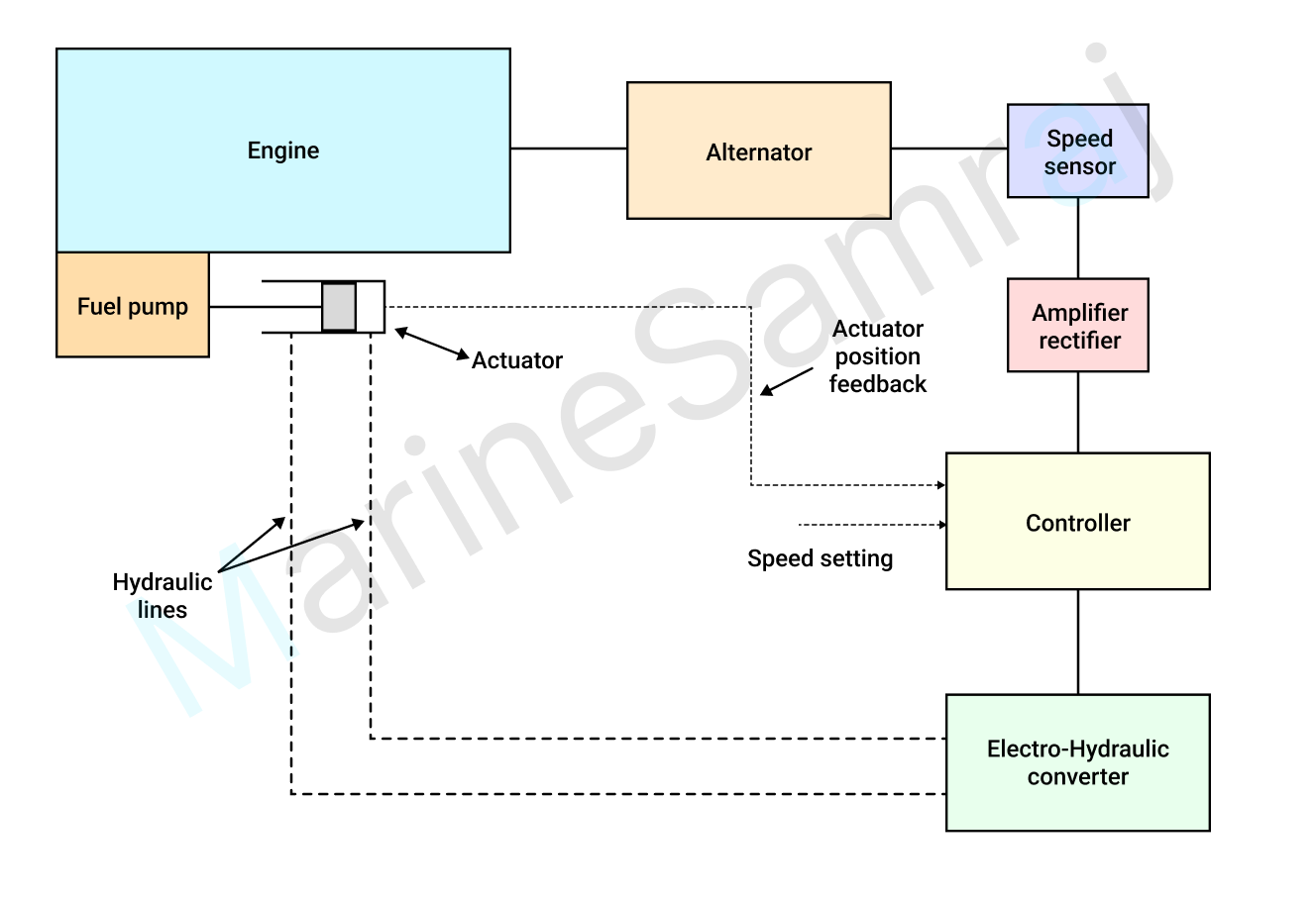

(a) With the aid of a block diagram state the usual check points for maintenance of an electronic governor fitted to an auxiliary diesel engine. (8)
