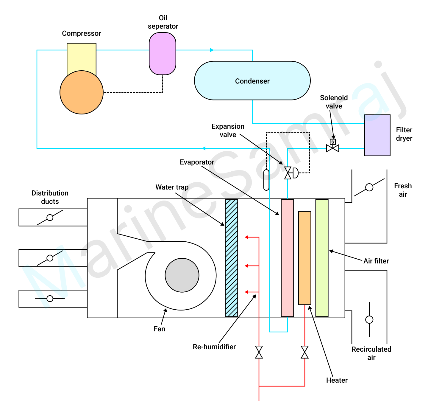

With the aid of a simple sketch, explain the "trouble spots" in a basic air conditioning unit and with reference to your sketch, explain the following:
(a) How the problem of increase in humidity of cooled air is overcome?
(b) How discomfort caused by the excessive drying effect of heated air is overcome?
Trouble Spots in a Basic Air Conditioning Unit
Refrigerant Leakage: Commonly occurs at the compressor shaft seal, condenser, dryer, oil separator, evaporator coils, or damaged pipes.
Condenser: Insufficient water or air flow and dirty tubes may cause high-pressure (HP) trip.
Filters: Blocked intake and recirculation filters lead to poor airflow.
