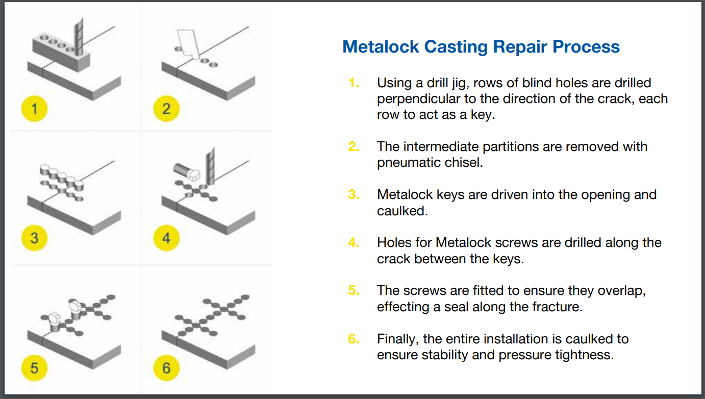

(a) Metal locking is a cold-working repair method for fractured castings. The process involves precisely aligning and clamping the fractured pieces. A series of holes are drilled perpendicular to the crack and then shaped to accept interlocking metal keys. These keys are inserted, followed by studs driven into the holes, each stud biting into the preceding one to create a tight, secure join. Finally, the studs and keys are ground smooth for a polished finish. This method avoids the use of heat.
